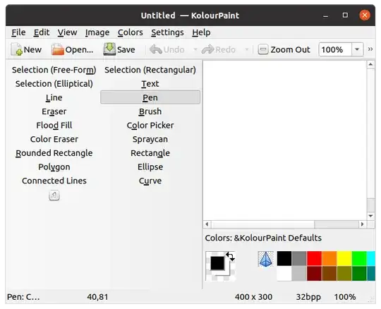

Kolourpaint is missing icons in the tools pane on Ubuntu 20.10 when installed using sudo apt install kolourpaint.
Is there a solution that does not require using the snap version or changing the system icon theme?

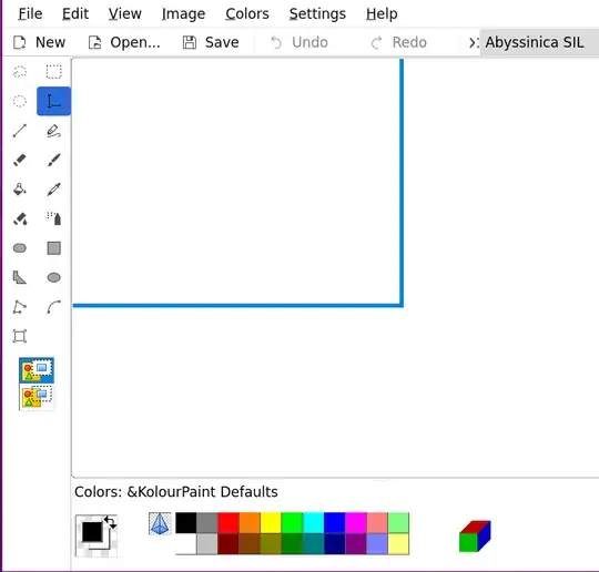

  1. install qt5ct:
sudo apt install qt5ct
  1. Open it:
qt5ct
  1. Navigate to Icon Theme, select any icon pack and click "Apply": Qt5 Settings
  2. Reopen kolourpaint, the icons should appear now: kolorpaint
