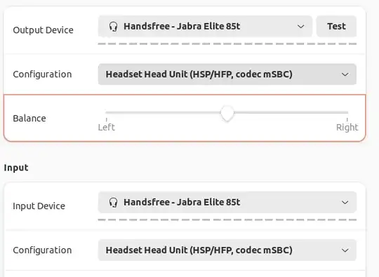

Finally this is the sound control panel:
This is the Sound Control panel
