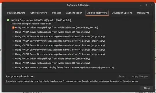

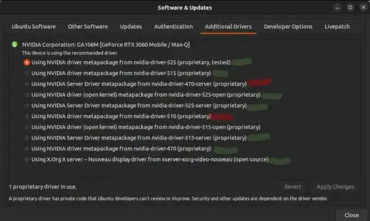

I have multiple drivers from the Additional driver window. I tried green highlighted drivers.
What I did?
  • Select drivers and install it. Click on restart now button.
  • After restart, open a terminal and run command sudo ubuntu-drivers autoinstall. Afterwards, reboot.
  • Go to Settings > Display. No effect. Same window as previous.

On my side, I just had to change the driver to the recommended (and tested) driver from Software & Updates and everything worked.
You should try with different Nvidia driver versions (for me 510 worked but 525 didn't). For me, the Nvidia website .run file installer worked perfectly.
