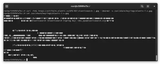

And gpg --dearmor produces binary output: dearmored elastasearch gpg key
