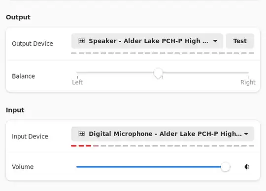

Once I backed out all the above changes, full sound system was detected:
Sound control panel
