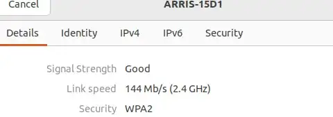

So what does the link speed mean exactly? Why is it 144Mbps? I thought my wifi router was capable of 300Mbps. Thanks.

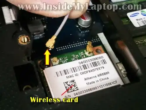

Please check the antenna connectors to your wireless card. Are both securely snapped into place?
Typically, there is a small door on the bottom of your laptop by which you can see the wireless card.
