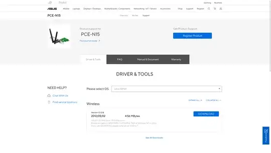

Here's a screenshot of the Asus website where I found the linux drivers for the Asus PCE-N15 wireless card. Asus website screenshot

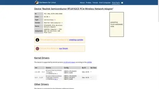

So I googled "realtek RTL8192CE PCIe Wireless Network Adapter drivers" and look what I found on one website which I took a screenshot of, notice how it says
Subsystem: ASUSTek Computer / PCE-N15 11n Wireless LAN PCIe Card
realtek screenshot

Looking for solutions for your chip (instead of typing ASUS) reveals this answer. I don't know if it will work or if I can recommend it.
Other suggestions online attempt to use ips=0 fwlps=0 aspm=0 instead.
May be some of these settings work for you.
