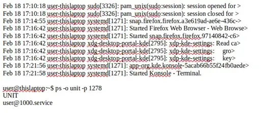

To try to get to the bottom of this (not really knowing what I'm doing, just following tips on the 'net), I found that the UID for fluidsynth process was 1278, so, in the terminal, tried the following (posted as a pic because I don't know how to paste the nesting)...
(The chart continued but I only copied to here to save space. Fludisynth doesn't connect to any of the remaining entries. Note that in the above, it is the default-GM soundfont that fluidsynth is loading. Fluidsynth needs a soundfont to be loaded before it can make any sounds. In that sf3 folder, there are several soundfont files, but for some reason this one is loading.
At the end of that output tree, this follows...)
I also checked the system log for fluidsynth and got this...
