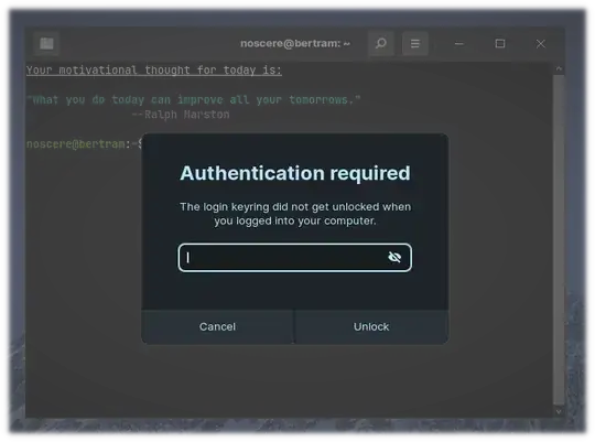

When I log into my ubuntu & gnome-based linux laptop, I enter/click my username, plop in my password and all is fine. Several seconds pass, and my desktop appears and I am good to go. There is no mention of any keyrings, it all happens behind the wizards curtain. I believe the keyring is automatically unlocked during the login process.
However, when I login using biometrics - in this case, with my face using the rather excellent howdy tool for ubuntu - also fedora/arch, after several seconds my desktop appears, and all would appear to be fine, just like above...
  • And then, an annoying modal dialog keeps popping up (1) ... again & again if I press cancel. enter image description here
So, I have to enter my password anyway (defeating the purpose of giving the peter-griffin to my camera, which has now become a look), or get annoyed and press cancel a number of times before it goes away.
