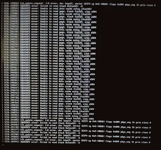

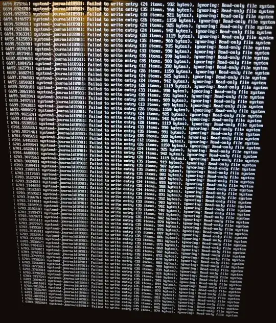

During the last two crashes, I pressed Ctrl + Alt + F1 (or F2) and took photos of log messages:
