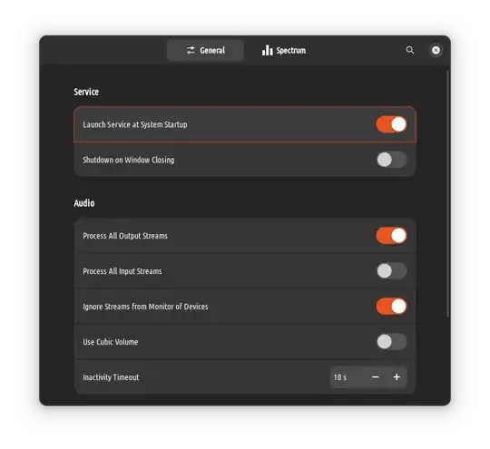

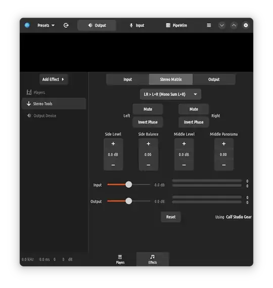

I managed to make mono audio output work in PipeWire by installing EasyEffects equalizer.
sudo apt install easyeffects
  1. Output > Effects > Add Effect > Stereo Tools
  2. On Stereo Matrix tab, choose "Mono Sum L+R". "Stereo to Mid-Side" seems to work too.
  3. In Preferences, make sure to enable "Launch Service at System Startup".
  4. Create presets for "Mono" and "Stereo" if desired (optional).
EasyEffects - Downmix audio output to mono EasyEffects - Launch service at system startup
