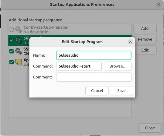

  2. Post this I had to do pulseaudio --start at every restart of the PC otherwise the Bluetooth connection could not be established again. I could establish the Bluetooth connections only post doing pulseaudio --start. I resolved this by going to Startup Applications Preferences. I could not find any pulseaudio application so I added one. Name - pulseaudio, command - pulseaudion --start enter image description here

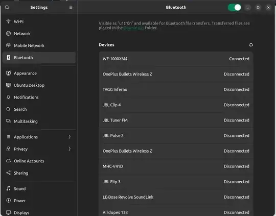

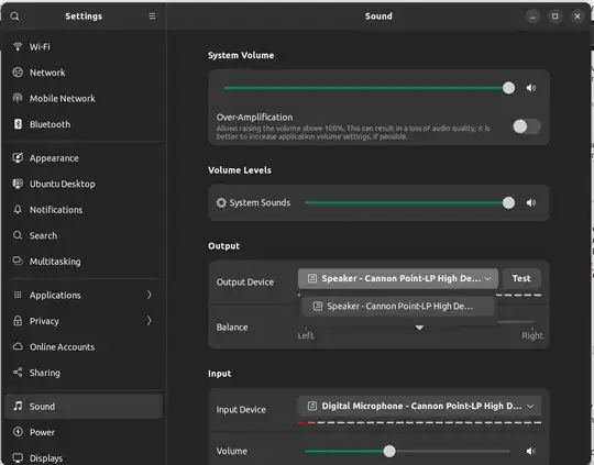

  3. Now my Bluetooth earphones connect enter image description here But the sound still comes from the the system speakers. In fact the Bluetooth earphones are not even listed under available devices. enter image description here. Also, when I put my earbuds back in the case the video that I am playing does pause. So my system is aware of the connected Bluetooth earphones on that level. Just cannot get the audio through them
