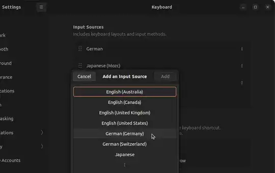

When I try to add German(neo, QWERTZ) under Activities -> Settings -> Keyboard -> Input Sources I cannot select anything with neo. Even with Other there are only German (<country>) and <other language> (German). When I try to enable Show Extended Input Sources in Gnome Tweaks -> Keyboard & Mouse it is already shown as enabled (disable, enable does not work).

Gunnar's: Edit II, solved it. German (Germany) is not a layout but indeed a folder that needs to be clicked enter image description here

Or possibly it's a very common misunderstanding with respect to the GNOME UI for adding input sources: Assuming that you have the German locale generated, you should not look for additional German layouts in "Other". Instead click "German", which will open a sub menu with multiple German layout variants.
