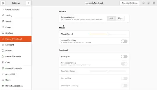

I disabled the touchpad on my Dell XPS 13 to work around a bug (the mouse cursor jumps around randomly as I type, selects text, etc.), possibly in 22.04, but the OS ignores it and the touchpad remains active.enter image description here
Why, you may ask, do I think disabling the touchpad would help? Because I noticed that as long as my hands are far enough away from the touchpad, the problem doesn't occur. So before I open up the laptop and pull the plug on the touchpad, I thought I'd check in here. Has anyone else experienced this in 22.04?

Rather than fully disabling the touchpad, disabling only "Tap to click" will be of equal help to you. The setting is in "Settings", "Mouse & Touchpad". The touchpad remains functional, clicking however now must be done by pressing the touchpad mechanically down.
Personally, I can quickly toggle the setting on or off by hitting Ctrl+Esc. This is effectuated by a small script triggered by that shortcut key. Here is how in case you are interested:
