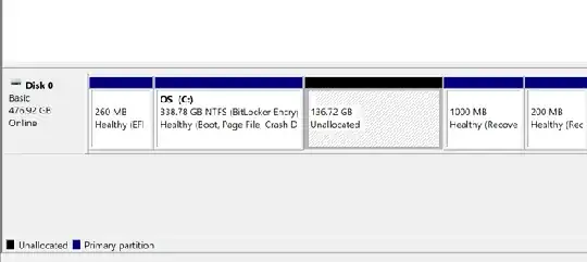

  • Search for “Disc Management” in windows and find the main partition, Also check the disc partition type MBR or GPT , from right clicking any partition → properties → volume, (For UEFI BIOS the partition will be GPT).
  • Right click the partition, shrink volume, here we are adding a space of 140 GB for Ubuntu from available.

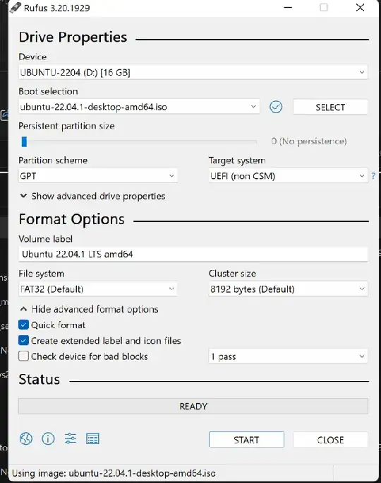

  • Open rufus as administrator, choose the following options , base boot image, Also choose the recommended “ISO Image mode” for writing after clicking start.
