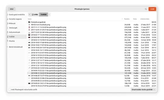

I updated ubuntu to 22.04 version and the preview of files when I open a file selector menu, for example to upload a image to twitter via browser, doesn't work anymore, how I can enable this feature? Thank you:
Now: enter image description here
I would like something like this: enter image description here
thank you :)
