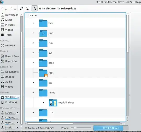

So I used a usb to boot into ubuntu and now I am looking at my normal desktop as it was before I moved the home directory to the external hdd. And while I have timeshift files to use to restore if needed, I am wondering what next step I need to do to fix this so that I can boot without the flash drive and ensure my home directory is the one on the external drive.

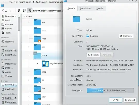

Looking at my file structure, I can see the new external drive where I copied the home directory to is mounted on home. I do still have that backup of home on this hard drive and intend to delete it to clear space as this main ssd is 80% full. But until I know if the instructions I followed somehow didn't copy all the permissions (not a complete noob but reading the journal indicated this could be the issue) or if some other step caused this, I don't want to do that. And I have my doubts about the new home dir being used as while writing this I received a similar error as yesterday: Your root partition is running out of disk space (0% remaining) only yesterday it was my home directory out of space.

I rebooted and could not get to desktop. I have attached screenshots of the file structure, indicating to me that the current session is using the home folder from the external drive. The 931.0 GB drive is the internal ssd. The external devices are 1.USB Flash live session

When I entered the live session for the first time, my partition on the ext hdd for the home directory is there. The internal ssd shows 100% full. Not sure if in live session you can actually see all the contents in folders from the ssd, but the home.orig (backup of home) shows very little in it, whereas it was equal to the ext home directory.
