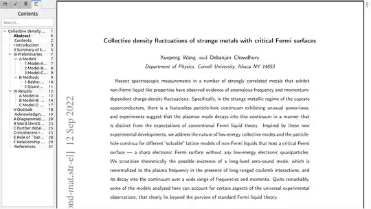

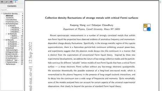

In this image, Okular is full screen, and the icon to open onboard is visible. First image
The second image shows that as soon as I click/tap the icon to open onboard, it goes behind the fullscreen Okular window.
Now there is no way to either annotate a document, or get out of the fullscreen mode without a keyboard (e.g. in a tablet).

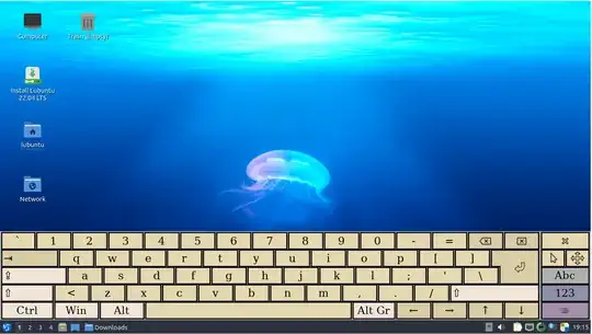

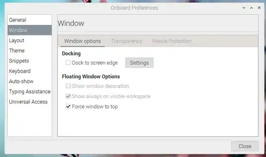

Open Onboard Settings and select "Window". enter image description here Uncheck "Dock to screen edge". Now, the "Force window on top" checkbox becomes active. Select it.
However, now onboard becomes a small window floating in the middle of the screen. To fix it, move onboard to the bottom of the screen (or your preferred position), and resize the virtual keyboard size it appropriately.

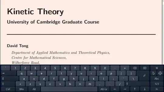

End results
