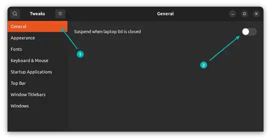

Method 1: Using GNOME Tweaks First we have to install gnome-tweaks-tool.
sudo apt-get install gnome-tweaks
Then open the gnome-tweaks and follow below steps:
  • Go to the General tab in the sidebar
  • And toggle off the 'Suspend when laptop lid is closed’ button change lid close behaviour in ubuntu
