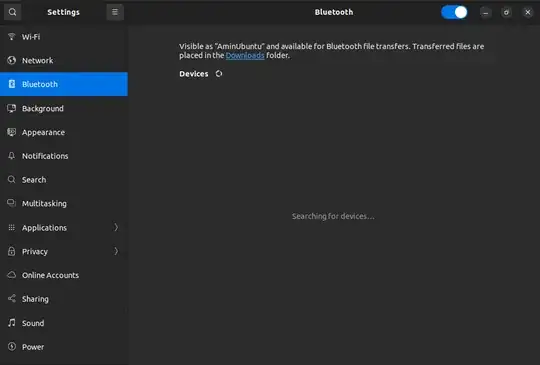

I installed ubuntu on my desktop computer recently. Its version is Ubuntu 22.04.1 LTS I have a Bluetooth dongle and it can find my cellphone and my laptop Bluetooth properly but it can't find my headset(model: Lenovo HE05) it even doesn't show its name on detected devices How can I solve this problem?

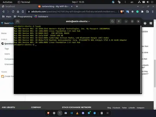

I use lsusb command to see information about Bluetooth dongle enter image description here
  1. Try updating your kernel to a higher version such as 6.5 or above (for me it worked).
  2. After this, install libspa-0.2-bluetooth with
    sudo apt install libspa-0.2-bluetooth
This package contains a plugin to make Bluetooth audio devices such as speakers and headsets available.
