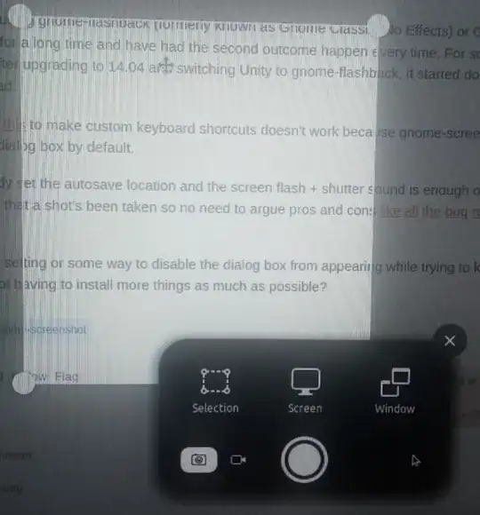

In Ubuntu 20.04 I could just press a shortcut, select an area and have that area in the buffer. Now it is gone and there is some annoying, irritating app.
How to delete it? If I delete it will screenshots in Ubuntu work?

It functions pretty much the same now. You press PtrSc, then select the area you want a screenshot of, and hit Enter when done. The result is available both in the clipboard and as a file, so you do not need to worry ahead where you want the output.

You cannot delete the new screenshot app, as it is built-in to GNOME Shell. However, you can install the gnome-screenshot app, which is the app that was used in Ubuntu before 22.04, using this command:
sudo apt install gnome-screenshot
You also need to install xclip, as suggested by Ben in this answer1:
sudo apt install xclip
Then go to Settings → Keyboard → View and Customize Shortcuts → Custom Shortcuts, click the + icon and add a new shortcut using the following as Command:
gnome-screenshot -a -c
The above command allows for selecting an area and saving directly to the clipboard, as you can find from man gnome-screenshot:
