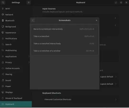

UPDATE JANUARY, 2025 : The default shortcuts in Ubuntu 24.04 are:
  1. To take a screenshot and save it in the Pictures/Screenshots folder, use Shift + PrintScreen.
  2. To take a screenshot of a window and copy it to the clipboard, use Alt + PrintScreen.
  3. To take a screenshot interactively, just use PrintScreen.
  4. Recording a screencast can be done with Shift + Alt + Ctrl + R.
Ubuntu 22.04
shift + ctrl + alt + r opens Record a screencast interactiveley
go to Settings > Keyboard > Keyboard shortcuts > Screenshots

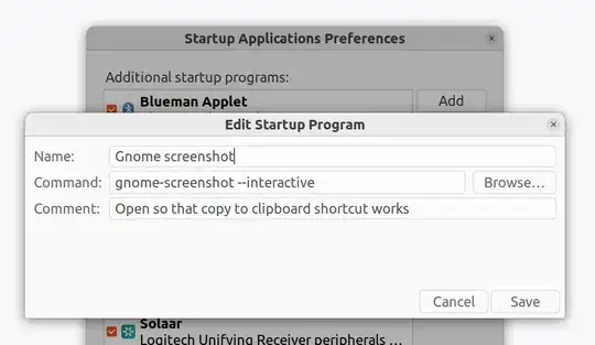

On my Ubuntu 22.04, the Ctrl Shift + Prt Scr shortcut does not work if the Screenshot program is closed. This seems to be a bug, which didn't happen on my last Ubuntu 22.04 machine.
My solution was to start the Screenshot program (gnome-screenshot) on startup, by adding this command as a startup application:
gnome-screenshot --interactive
I leave the application running in the background and I can now use the shortcut again, for quick and easy screenshots to clipboard.

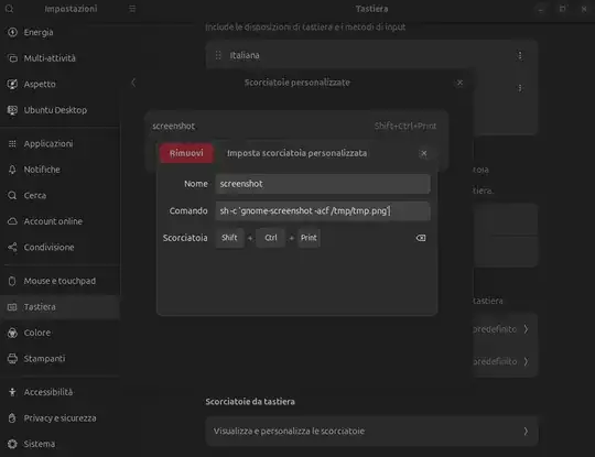

Updated on 29 March 2025
It works for me on Ubuntu 24.04.2 LTS using the following command:
sh -c 'gnome-screenshot -acf /tmp/tmp.png'
Note: you can use this command as a custom keyboard shortcut
