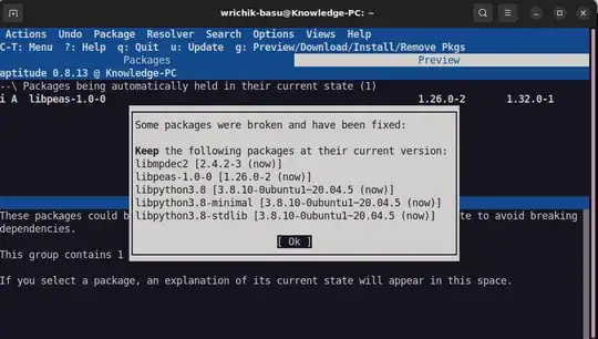

I opened aptitude by sudo aptitude. Under "Upgradable packages", there was 1 package. If I press g on that, I get the following screen:

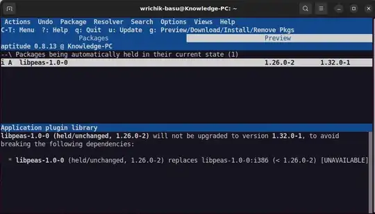

I clicked on "OK" and then scrolled down to libpeas-1.0-0 to find:

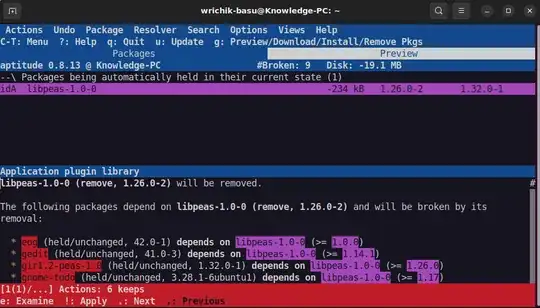

If I click -, I get the following warning:
See that important applications like gedit will be removed if I remove this.
Now what am I supposed to do? How can I solve this error?
