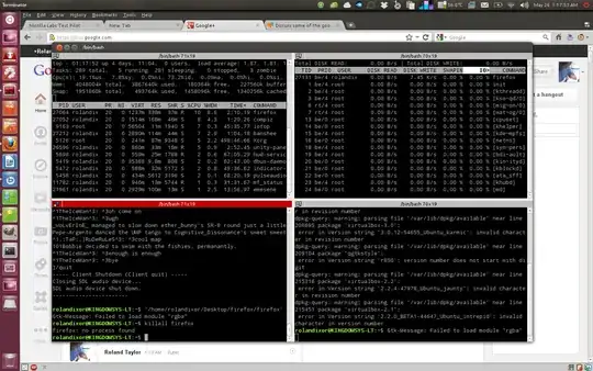

I would like to leave an application running in my terminal that shows me the memory usage, similar to how top shows CPU and other info, and iotop shows the top I/O users.
Top and iotop
Does such an application exist?
P.S. I know top shows memory usage as well, but I'm talking about sorting by top memory usage and not showing any other info (similar to what iotop does).

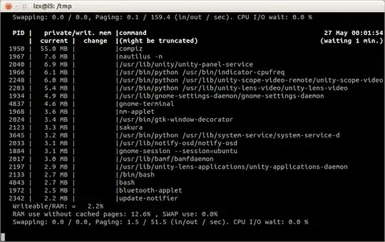

The closest I could find is memtop, a Python script available here on Google Code.
Screenshot: enter image description here
How to use memtop
  • It's a Python script, so simply do a sudo mv memtop-1.0.0.py /usr/bin/memtop.py and a chmod +x /path/to/memtop.py to make it executable
  • Default update period is 15 min; use switch -p 1 to make it 1 minute, etc. (can't go lower than that unless you modify the source)
  • Use -l N, where N is the number of processes you want to show, depending on the size of your terminal.
  • Use -m to show "more" information, i.e. the Swap/Page stats at the bottom of the screenshot.

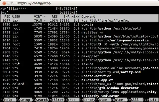

The htop disguised as memtop option
If you don't use htop otherwise, it's pretty easy to set it up with the F2-setup option to look like memtop:
  • htop config is stored in ~/.config/htop/htoprc, so just delete htoprc to restore normal htop.
