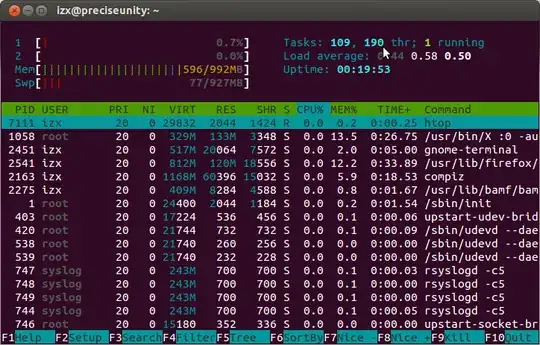

For better metrics and ease-of-use, I recommend you use htop instead of top, with the "Hide userland threads" option enabled:

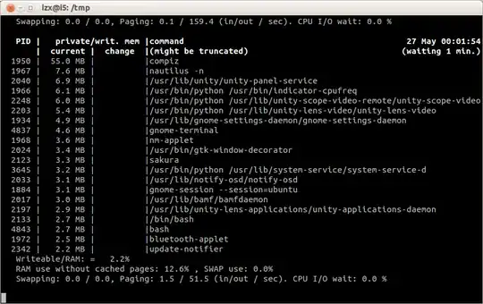

Also look at memtop:
