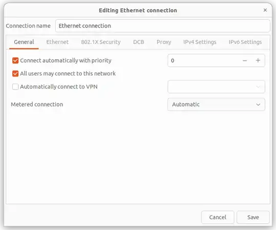

Once you have done everything on that site open the app Advanced Network Configuration. If you can't find this app by searching for apps, then open a terminal and enter:
nm-connection-editor
Select the network you want to use VPN in. For example, Ethernet Connection, and click on the gear icon at the bottom left corner of the window.
Go to the General Tab and then select the check box next to Automatically connect to VPN.
Then use the drop-down menu next to it to select the ProtonVPN set up you have already done.
Repeat for each WiFi network you want to use VPN.

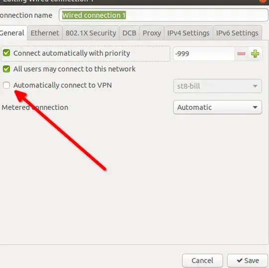

Answering only this part
It would sure be nice if my ProtonVPN could connect automatically whenever I have a network connection.
You can use the builtin feature of Network Manager to do this.
Edit the connection you are using and tick the box Automatically Connect to VPN.
