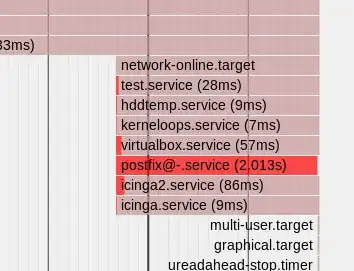

Type=oneshot means it will only be executed once.
The line requires=network-online.target states that the service needs the service network to be online and only executes after=network-online.target
You can see the service (test.service) started after the network.service

TIP: Pic was created with systemd-analyze plot > output.svg
