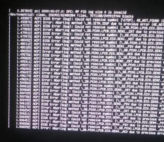

PS: I have this error at startup that could be a way, but I have no idea of what it is:
error at startup

Add loglevel=3 to GRUB_CMDLINE_LINUX_DEFAULT in etc/default/grub, so that it will look like this:
GRUB_CMDLINE_LINUX_DEFAULT="quiet splash loglevel=3"
Then update GRUB using this command:
sudo update-grub
That's it.
Note that the above didnt't fix the ACPI BIOS Error, but now my speakers are working perfectly.
