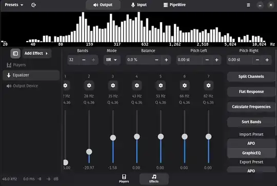

Easy Effects
For PipeWire there is Easy Effects, available as a flatpak on Flathub.
screenshot
