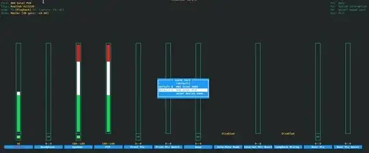

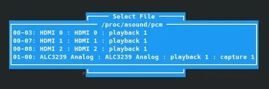

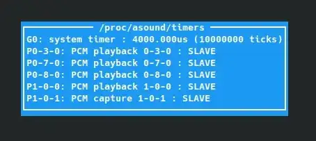

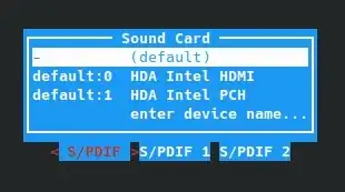

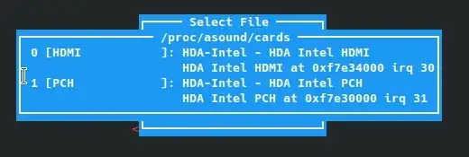

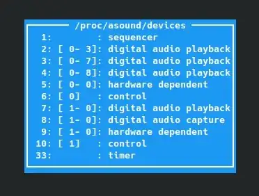

Opened alsamixer in the console See included pictures

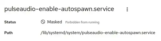

As it turns out pulseaudio-enable-autospawn.service somehow got masked. I’ve had this problem in the past and it took me a while to figure out how to unmask it. Now I’ve tried to same steps to unmask a service as suggested here: systemctl, how to unmask but it just won’t work.
file /lib/systemd/system/pulseaudio-enable-autospawn.service
/lib/systemd/system/pulseaudio-enable-autospawn.service: symbolic link to /dev/null
Shows that there is a sym link to dev/null which is why the unmask command won’t work as I understand it.
As per the instructions in the above link I’ve tried to remove the sym link.
sudo rm /lib/systemd/system/pulseaudio-enable-autospawn.service
[sudo] password for <username>:
There was no output here, which should mean the command was success, right?
Next step was systemctl status pulseaudio-enable-autospawn.service Unit pulseaudio-enable-autospawn.service could not be found.

Quick update; I started up the computer again to do something else, but out of curiosity I had a look at that annoying pulseaudio-enable-autospawn.service. To my surprise it was no longer masked and actually running as well. There still weren't any output devices visible so I had a look at other sound-related services. It turned out that /usr/lib/systemd/user/pulseaudio.serviceand/usr/lib/systemd/user/pipewire-pulse.service` were inactive. I started them both and sound was restored, both the internal speakers of my Lenovo ThinkCentre and the HDMI output are working again.
I'm not sure how this happened, and I'm pretty sure that after a reboot it will break again. Also, the standard volume control in the bottom panel still isn't showing the output devices, but I'm hoping that's a quick fix for later.
I'm still curious what went wrong, so if anybody can spot the problem, feel free to comment. With any luck it can help prevent this problem in the future, both for others and myself.

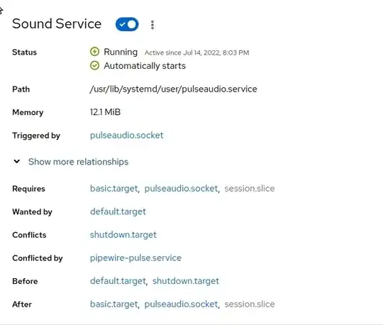

Rebooted again, and this time I was able to manually start the service and sound worked again. I used the app "Cockpit" (see screenshot below) to start it as I wasn't sure anymore how to start a service the proper way.
The problem now is that the Pulseaudio service won't start on it's own, and for today I'm done trying to fix it. Hopefully in the coming days someone is able to point me in the right direction...
