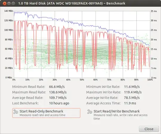

Last but not least is the read/write screengrab, this is new. It used to stay pretty consistent over the duration of the test.
read write screengrab
EDIT- When I powered on this morning the drive had changed from /dev/sda to /dev/sdc, strange. I'm certain that hasn't happened before and I'm certain it was /dev/sda. I swapped SATA cables with a known good one and saw that same failure at about 10GB transfers. I didn't change SATA ports yet, I'll try that next. (Edit #2, it was the SATA port, changing it fixed the problem. Flagging this as too localized.)

The SMART tests are "isolated", i.e once smartctl commands the drive to do a test, the drive handles everything internally and then reports back. So this may not reveal problems between the drive/controller and your motherboard.
  • The obvious inference is a bad cable, but that isn't supported by the disk-utility graphs; reads should be affected too. Still, swap cables/SATA ports and see if it makes a difference.
  • Run the long self-test with smartctl -t long ; fastest in captive mode -C (unmount all partitions!), and when done, check status/errors with -l (the test will abort as soon as an error is detected)
  • If that works out, do you remember anything that could have triggered this problem software-side? Kernel upgrade/downgrade, etc.?
  • Finally, if all your other disks are fine, this may very well be a bizarre bug with the drive's write-cache controller. Backup data and RMA it as soon as possible.
