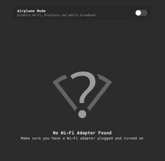

Machine       : ASUS X550VX
System        : Ubuntu 22.04
Kernel        : 5.15.0-40-generic
Wireless Card : Realtek RTL8723BE
Suddenly my wifi is gone and there is no option to turn it on, it says "No wifi adapter found". It was just fine before, I didn't mess with any network settings and it's been 2 days now that my wifi isn't working. There has been no luck with update from apt update and apt dist-upgrade.

What I have tried (with many reboots) :
  1. rfkill unblock all
  2. sudo apt reinstall network-manager && sudo service network-manager restart
  3. sudo snap install network-manager (installing network manager via snap)
  4. Installing iwlwifi following this thread : No WiFi Adapter Found with fresh Ubuntu 20.04 install on MSI GE66 Laptop, and other strange behavior
  5. Installing driver for RTL8723BE from git clone https://github.com/lwfinger/rtw88.git
All with no luck then I found some interesting information :
    sudo dmesg | grep rtl
    [    5.510743] rtlwifi: disagrees about version of symbol ieee80211_connection_loss
    [    5.510746] rtlwifi: Unknown symbol ieee80211_connection_loss (err -22)
    [    5.510926] rtlwifi: disagrees about version of symbol ieee80211_start_tx_ba_session
    [    5.510928] rtlwifi: Unknown symbol ieee80211_start_tx_ba_session (err -22)
    [    5.510938] rtlwifi: disagrees about version of symbol ieee80211_rate_control_unregister
    [    5.510939] rtlwifi: Unknown symbol ieee80211_rate_control_unregister (err -22)
    [    5.510949] rtlwifi: disagrees about version of symbol ieee80211_get_hdrlen_from_skb
    [    5.510950] rtlwifi: Unknown symbol ieee80211_get_hdrlen_from_skb (err -22)
    [    5.510964] rtlwifi: disagrees about version of symbol ieee80211_find_sta
    [    5.510965] rtlwifi: Unknown symbol ieee80211_find_sta (err -22)
    [    5.510972] rtlwifi: disagrees about version of symbol ieee80211_tx_status_irqsafe
    [    5.510973] rtlwifi: Unknown symbol ieee80211_tx_status_irqsafe (err -22)
    [    5.510985] rtlwifi: disagrees about version of symbol cfg80211_put_bss
    [    5.510987] rtlwifi: Unknown symbol cfg80211_put_bss (err -22)
    [    5.510995] rtlwifi: disagrees about version of symbol ieee80211_stop_tx_ba_cb_irqsafe
    [    5.510997] rtlwifi: Unknown symbol ieee80211_stop_tx_ba_cb_irqsafe (err -22)
    [    5.511003] rtlwifi: disagrees about version of symbol wiphy_to_ieee80211_hw
    [    5.511004] rtlwifi: Unknown symbol wiphy_to_ieee80211_hw (err -22)
    [    5.511015] rtlwifi: disagrees about version of symbol wiphy_apply_custom_regulatory
    [    5.511016] rtlwifi: Unknown symbol wiphy_apply_custom_regulatory (err -22)
    [    5.511022] rtlwifi: disagrees about version of symbol ieee80211_rate_control_register
    [    5.511023] rtlwifi: Unknown symbol ieee80211_rate_control_register (err -22)
    [    5.511033] rtlwifi: disagrees about version of symbol cfg80211_get_bss
    [    5.511034] rtlwifi: Unknown symbol cfg80211_get_bss (err -22)
    [    5.511051] rtlwifi: disagrees about version of symbol wiphy_rfkill_set_hw_state_reason
    [    5.511053] rtlwifi: Unknown symbol wiphy_rfkill_set_hw_state_reason (err -22)
    [    5.511058] rtlwifi: disagrees about version of symbol wiphy_rfkill_start_polling
    [    5.511060] rtlwifi: Unknown symbol wiphy_rfkill_start_polling (err -22)
    [    5.511067] rtlwifi: disagrees about version of symbol freq_reg_info
    [    5.511068] rtlwifi: Unknown symbol freq_reg_info (err -22)
    [    5.511080] rtlwifi: disagrees about version of symbol ieee80211_resume_disconnect
    [    5.511081] rtlwifi: Unknown symbol ieee80211_resume_disconnect (err -22)
    [    5.511088] rtlwifi: disagrees about version of symbol ieee80211_beacon_get_tim
    [    5.511089] rtlwifi: Unknown symbol ieee80211_beacon_get_tim (err -22)
    [    5.511099] rtlwifi: disagrees about version of symbol cfg80211_unlink_bss
    [    5.511100] rtlwifi: Unknown symbol cfg80211_unlink_bss (err -22)
    [    5.511107] rtlwifi: disagrees about version of symbol ieee80211_rx_irqsafe
    [    5.511108] rtlwifi: Unknown symbol ieee80211_rx_irqsafe (err -22)
    [    5.939896] Bluetooth: hci0: RTL: loading rtl_bt/rtl8723b_fw.bin
    [    5.941270] Bluetooth: hci0: RTL: loading rtl_bt/rtl8723b_config.bin
    [    5.941298] bluetooth hci0: Direct firmware load for rtl_bt/rtl8723b_config.bin failed with error -2
I don't know what else to go or to try from here, any suggestions ?

To solve the problem, I changed the kernel from 5.17 to 5.13. I then installed network drivers iw, iwd, linssid, urfkill and rebooted.
