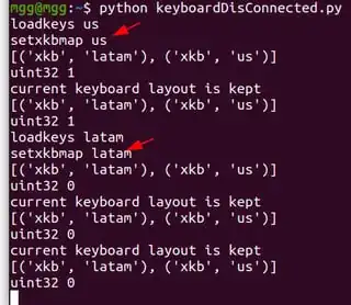

- run
python keyboardDisConnected.py, connect and disconnect your usb keyboard you should see something similar to this:
