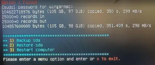

Results of this bash script on an Ubuntu server run: Results of this bash script on an Ubuntu server run It could do the trick, but it's not easy I've made a mistake with the disk and file locations probably, because my system couldn't start anymore. I was good for reinstalling it.

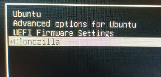

default grub with Clonezilla entry

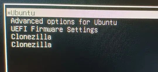

After that, I selected Clonezilla what made a new entry in the grub menu with the same name:
Double Clonezilla entry
So I tried to boot on the new entry, and it worked fine, but why does it make this second entry first ?

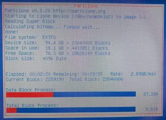

At top of that, I was gladly surprised that Clonezilla has detected my FakeRaid and the partitions on it without any additional settings. I could save the image on it without inconvenience.
Clonezilla partition to file
It took approximately 10 minutes with the verification included. Now I'm still searching how to make it a menu to choose between backup or restore only, with always the same source and destination alternatively. I presume this must be possible, so I continue my research.

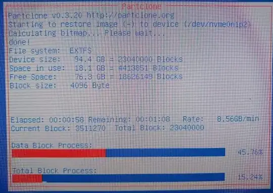

  6. I tested a property driver from Nvidia that crashed my kernel. That made me a good reason to test the restore, that has been done with success:
restoring disk image
With this, I've found a correct answer to make a recovery menu entry at boot, by using Clonezilla. Now I can choose to save or restore the partition I wanted to.
