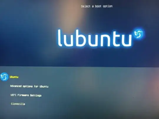

I use Lubuntu 22.04 LTS on my computer, and am testing grub editing.
It seems Lubuntu is using some kind of graphical interface to show grub. enter image description here
Can I disable it to use the same as Ubuntu's default?

I can see it pointing thos two files: `/etc/default/grub.d/lubuntu-grub-theme.cfg' /usr/share/grub/themes/lubuntu-grub-theme/theme.txt
Should the solution be to delete the /usr/share/grub/themes/lubuntu-grub-theme/theme.txt so it doesn't load it ? Will this work ?
