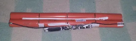

Ubuntu like most modern OSes, for this matter, has little to do with your battery. Communication between the OS and the battery happens indirectly and across many layers. Nowadays, laptop batteries are equipped with their own management and reporting Smart Battery System that is made possible by electronics inside the battery package itself and it looks something like this:
