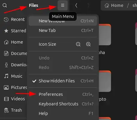

Nautilus (from Bash prompt), AKA "Files":
The three dash (horizontal version of ///) clickable gadget just beside "_" (minimize window) in the upper right corner of the window has the settings.
In that menu you have Preferences > Search and preview (tab) > Thumbnails: move away from Never if set to that.

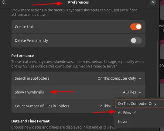

Can be set system wide and chrome will pick that preference
Go to nautilus (files) > preferences > Show thumbnails > all files
works with Ubuntu 24.04 as well
