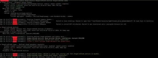

I have VPS, and after checking systemctl, I noticed that my fwupd-refresh.service failed.
terminal
Can you explain the problem, and could you help to fix it?
