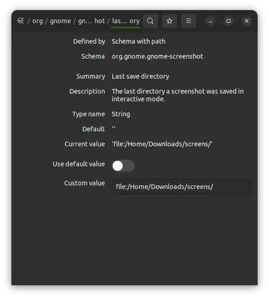

Use dconf-editor
An alternative method is to change the path of the autosave directory by using dconf-editor.
dconf-editor is not installed by default, so to install it open a terminal and run:
sudo apt install dconf-editor
You can then run the utility either from terminal with dconf-editor or select the GUI directly from Show Applications.

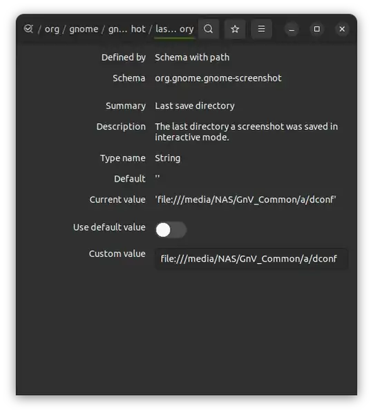

Once in the editor, select apps and then click Search "apps" folder and enter screenshot in the search box. Then select /org/gnome/gnome-screenshot/ from the list presented.
The next step is to select auto-save-directory and disable Use default value, after which you can then enter a custom value in the field provided.
Using the example above, enter /Home/Downloads/screens (or the path of your choice) and save accordingly.
On entry to the utility and at the point of saving the image, you can override the defaults to any folder of your choice (or filename), which will be remembered the next time you use the tool.
