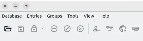

This is how the window bar looks with any other snap I have installed, here it's KeepassXC:
Normal looking window bar
To me it looks as if Firefox uses some other theme and does not respect the system's theme settings.
