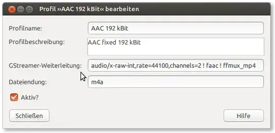

  1. Install the package gnome-media-profiles, gstreamer0.10-plugins-bad-multiverse and soundconverter
  2. Launch the command (ALT+F2) gnome-audio-profiles-properties and create a new profile called AAC192. For "File extension" use m4a and in the field "GStreamer pipe", enter
    audio/x-raw-int,rate=44100,channels=2 ! faac ! bitrate=192 ! ffmux_mp4 AAC Profile
  3. Start Sound Converter, go to "Settings" and for "Format", choose GNOME Audio Profile. Now you can select AAC192
