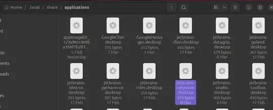

  • When viewing .desktop files in a File browser like Nautilus, the files will appear like typical text files or potentially with gear symbols on them enter image description here

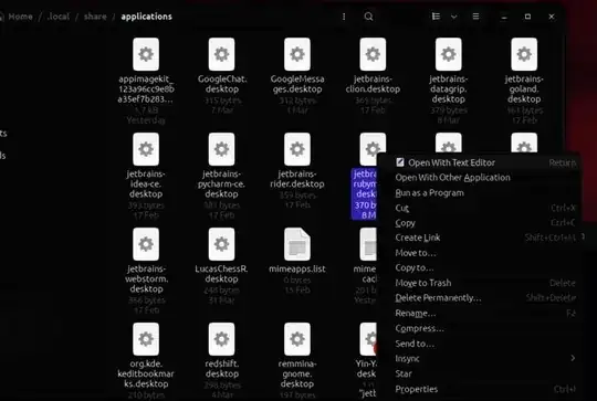

  • When double-clicking on a .desktop file the default file action set for that mime-type in xdg-settings will be applied, in this case the .desktop file will open in your default text-editor enter image description here

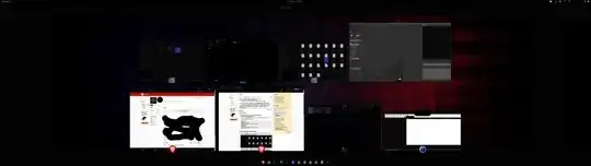

      you can check your xdg-mime settings like this: enter image description here
    As you can see, my default is GNOME Builder too
  • I've been showing the above using the JetBrains CLion IDE .desktop file, now let me show you how to properly utilize the .desktop file.

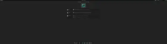

    1. first access your application menu with Super/Win key on your keyboard, or by clicking on the 3x3 grid icon on your taskbar [note: this can differ depending on your desktop environment and your configuration] enter image description here
    2. start typing your application name; in your case TEST but in my example CLion enter image description here
