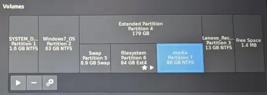

There's a laptop I bought about 10 years ago, it arrived with Windows 7 (which I almost never used) and back then I installed Ubuntu in dual-boot (last update was to Ubuntu 16.04). So It had three major partitions: One only for Windows, second only for Ubuntu, and third which both OS's could read and write to (I'm not sure which file system I used for it, back then). The actual number of partitions is actually bigger, since there's also one for Linux Swap, and a couple of Windows/Vendor (Lenovo) recovery and such: sorry for the crappy quality of the "screenshot"
After a few good years, I haven't used this laptop for several years. Recently I opened it - booted into Windows, I could see the shared partition (Called 'Media'). Then I rebooted into Windows again (in order to install some updates), during the boot process it executed ScanDisk (or similar). After that, the Media partition seemed to be wiped!

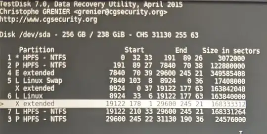

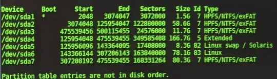

I already tried using TestDisk (using this guide), but it couldn't list any deleted files. However, I did notice that when TestDisk lists the now-wiped Media partition (partition 7 in the attached screenshot below), just before it - there's another (lost?) partition (highlighted in the screenshot below), which ends in the same sector as partition 7, but starts a few sectors before it. TestDisk's list of partitions result of running 'sudo fdisk -l'
I have a feeling that Windows' ScanDisk made something to the Master File Table (or something similar) of this partition, like reset or perhaps somehow skip/ignore it, if that makes sense. So, can it be that I should shift partition 7 to start where this mysterious X partition starts, and this might recover the whole file system mappings for the Media partition? How can I do that, and what/how should I backup prior to that?
