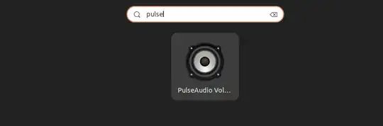

  1. Open PulseAudio Control: PulseAudio Control

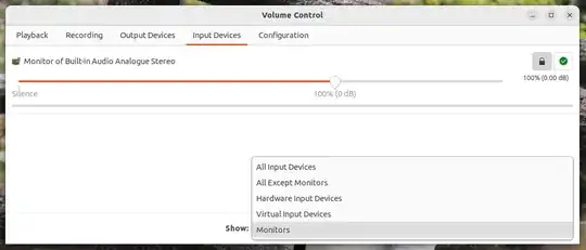

  2. Click the "Input Devices" tab, then select "Monitors" from the bottom filter: Input Devices

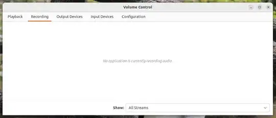

  3. Click on the "Recording" tab. You will likely see the list is empty: Recording

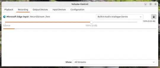

  5. The "Recording" tab in PulseAudio Control will now show the application that is using the microphone: Recording Active Note: The bar under "Silence" will now move to indicate it is picking up sound.
  6. Change the "from" selection from the current microphone to "Monitor of Built-in Analogue Stereo". This may be named slightly differently on your system, but the value will start as "Monitor of ...": Recording a Different Source
