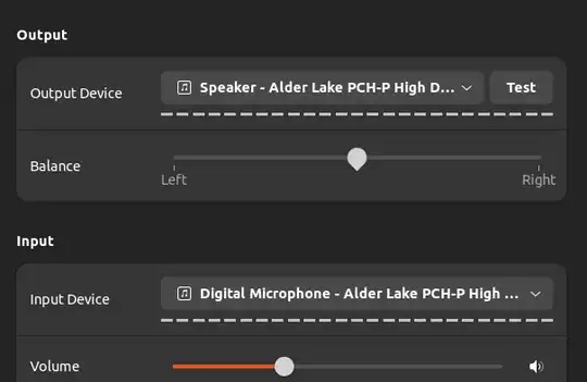

I'm using Ubuntu 21.10 and have just started getting strange audio outputs on my laptop speakers, despite nothing playing.
The sound itself is quite hard to describe, but sounds roughly like a sort of modulated white noise sound. It is also quite loud, and plays out of the laptop speakers, and is unaffected by system volume (this has lead to a few embarrassing meetings where I can't make my laptop stop making this weird noise and just have to reboot).
It seems to be triggered somewhat randomly, but I can also force it to happen by:
  • playing any audio (i.e. a youtube video)
  • running a pulseaudio ... command
  • opening the sound section of the settings app
I found the following questions which sound like the same issue, but neither solutions have worked for me:
Some details of the system:
  • Razer Blade 15 2022 (has a nvidia discrete GPU, and an Alder Lake 12th gen CPU, both of which have caused other driver-related issues)
  • uname -r: 5.13.0-35-generic
  • Ubuntu 21.10
  • Dual booting Windows 11 (worth mentioning Windows has no such sound issues)
  • Secure boot is off, as is Windows fast boot
Any help would be very appreciated
I had the same problem on the same machine (razer late 2022), and indeed it was partially solved by shutting down windows instead of rebooting. However,the microphone still doesn't work, and the "left/right" test output is reversed.
