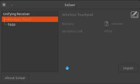

1: Wireless Touchpad Codename : Wireless Touch Kind : touchpad Wireless PID : 4011 Protocol : HID++ 2.0 Polling rate : 8 ms (125Hz) Serial number: DCBF0037 The power switch is located on the base. Battery: unknown (device is offline).
2: Wireless Rechargeable Touchpad T650 Codename : T650 Kind : touchpad Wireless PID : 4101 Protocol : HID++ 2.0 Polling rate : 8 ms (125Hz) Serial number: E6CBD4AB The power switch is located on the base. Battery: unknown (device is offline).
This output is after it has been supposedly paired, as one can see from the "Unpair" button on the solaar GUI:
solaar show output
