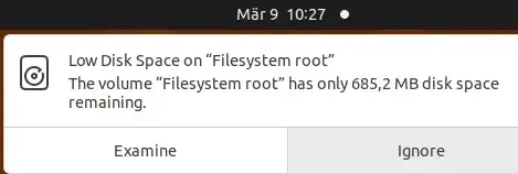

I just got this warning
I tried to follow this and this questions, but I fail to understand why this is happening when I still have a lot of space available in home:

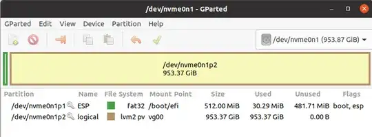

The result of gparted is this:

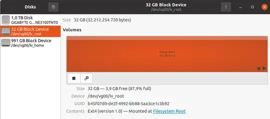

The results of the Disks tools are:
