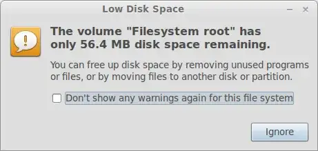

Running 11.04 Low disk space warning. Results of df:

What application can be used to free up space or move files or increase the /root filesystem, safely.

This IS GROWING>>>>

You're only using 35% of your root-partition, it's probably a bug that it tells you it's low on space (or it's set to 10 GiBs or something like that, since most less experienced users don't differ / from /home)
To answer the question, if you like to resize partitions, you should use gparted. I'm quite sure this is still available on the Ubuntu Live-CD (search for "gparted" or "partition editor") - if you can't find it on the Ubuntu CD, try downloading the GParted Live-CD.

a little further exam revels that rsync is running and the / is growing obviously, for whatever reason, copying itself as a backup. ~killing rsync stops the increased production of used disk space.
