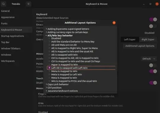

I have this helpful setting enabled in Tweak Tools when I use an annoying external Apple magic keyboard:
This setting makes the keyboard function in my view normal (super key is to the right of the control key).
However, this setting in tweak tool also affect my laptop own keymap. Can I somehow make this setting only for this annoying external Apple magic keyboard?
