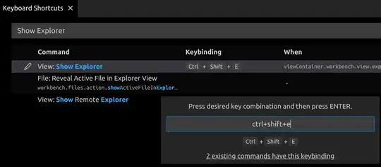

That being said, as VS code seems not to have that problem, @quasímodo's advice worked for me: Just starting code with the respective env variable:
GTK_IM_MODULE=xim code
  1. must be the first instance started (not another already “hanging around”
  2. you may actually kind of verify, you are on the right track: Go to keyboard settings, find Show Explorer, click key-binding to re-define the very same shortcut. If you get previewed ctrl-shift-undefined, you are on the wrong track... (press esc to not actually redefine then)
